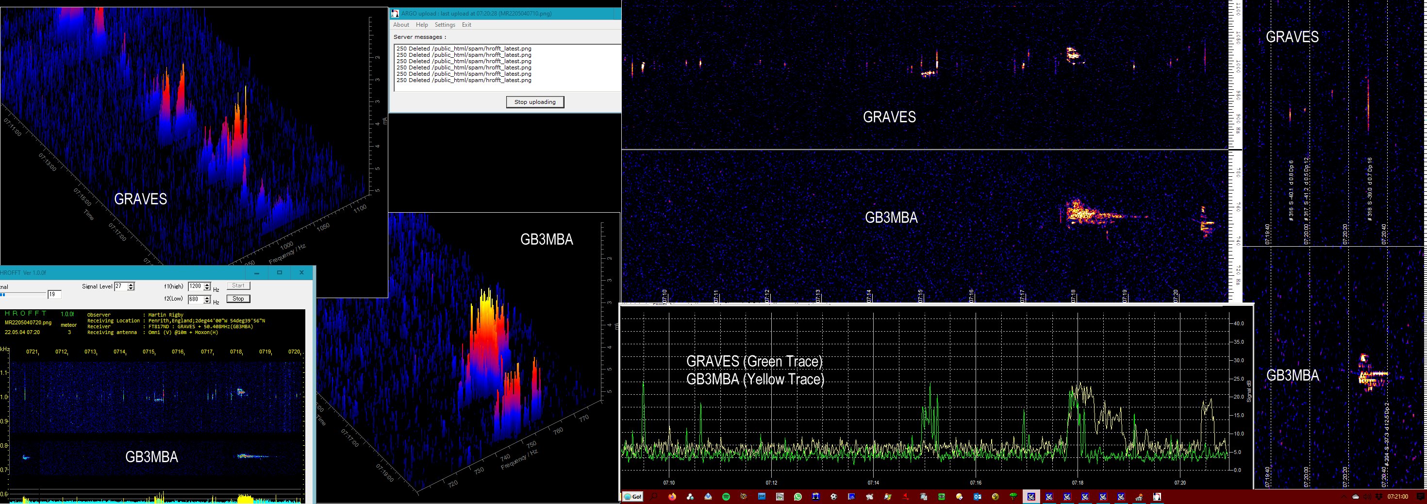

Brian
Please find attached a screengrab of my console from yesterday (4th May 2022) showing (inter alia) the simultaneous reception of a burst via GRAVES and GB3MBA in its temporary test location.
When my system is online I monitor GRAVES a "50MHz" beacon (hitherto it has generally been BRAMS on 49.97MHz), but I have retuned my receiver to the new UK frequency for this grab.
It will be interesting (to me anyway) to note how many "coincident" echoes are received once the UK beacon is in its final location.
I am in Penrith (Grid IO84pp) and the aerial is a home made "Moxon" in my loft aligned approximately SE.
I hope you are as pleased with this result as I am! (I have annotated the result hopefully to clarify what is being seen).
Many thanks for your (and others' of course) efforts, I for one have been looking forward to having the option to use a UK source for quite some time

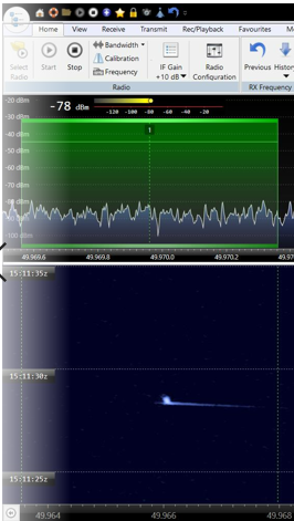

Hello Martin
Great stuff and thanks for the report. When we were testing the proof of concept Web RX system I saw echoes from BRAMS VVS on 49.440 and our test beacon which was then at Andy's location ( G4JNT ). So I expect we will see quite a few coincident echoes with the Belgium beacons and a few from Graves. This morning I'm doing some work on the beacon but hope to put it back on later .. check the status page. Over the week end I'll start dismantling the antenna for transport to Sherwood next week end.
I will be particularly interested in head echoes like the one I have ( hopefully ) attached as these are what we will need to triangulate meteor events and calculate trajectories / radiants.
