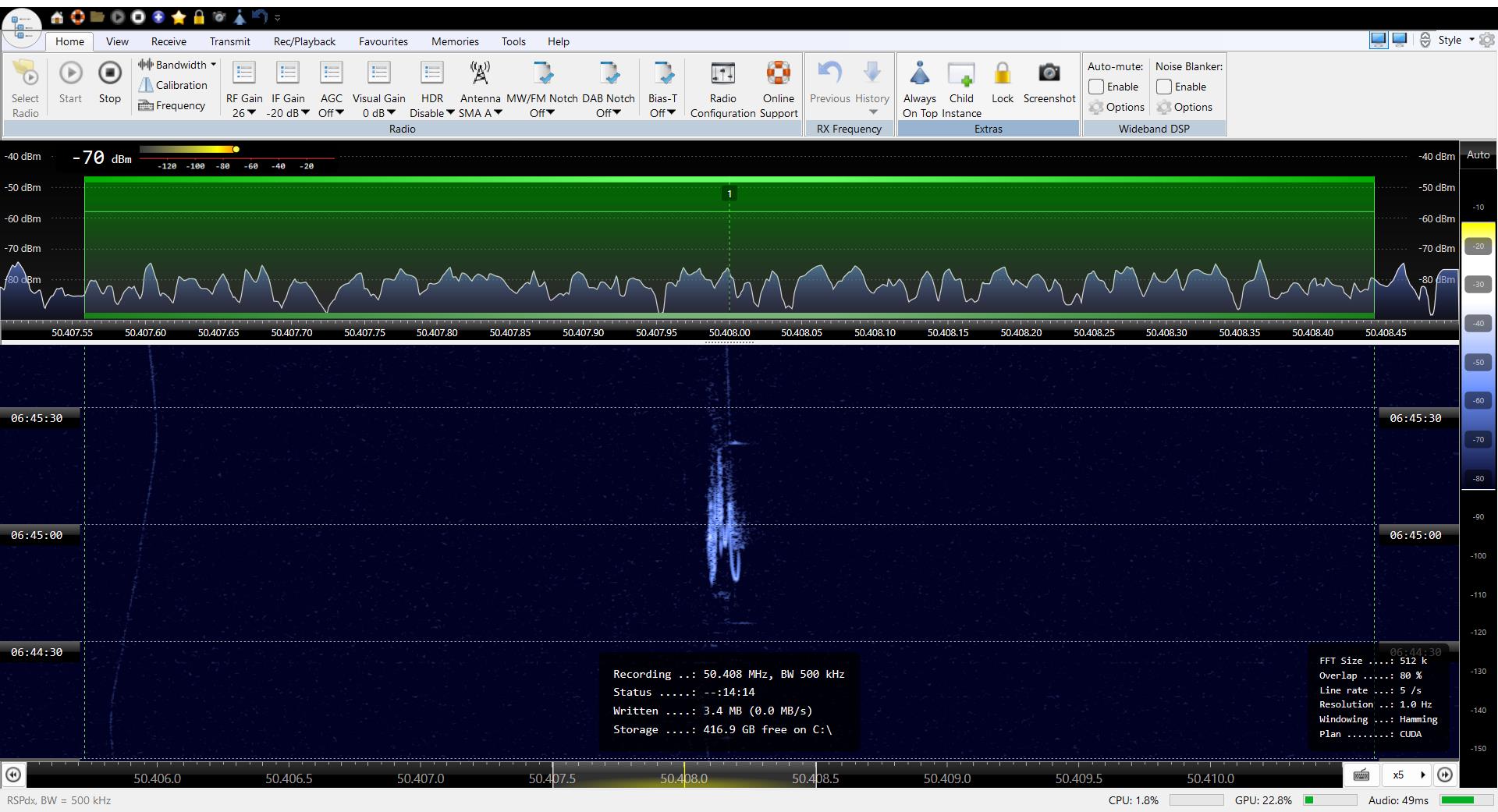

Lyrids - 23 April 2023@06:45:46 Echo
Spectrograms for analysis and feedback
Echo from GB3MBA thoughts on what it shows appreciated "meteor fragmentation or a meteor passing through different layers of ionisation within the ionosphere maybe ?"

Re: Lyrids - 23 April 2023@06:45:46 Echo
Post by G3ZJO »
This looks to be a good example of an epsilon reflection. The meteor has left a vertical ionised trail which has been swept HF, +ve Doppler and LF, -ve Doppler by wind shear in the ionosphere.
Post by Aut0Star »
Epsilon reflection is not a term I have heard before, however the following link gives and explanation:
https://www.zooniverse.org/projects/zoo ... /about/faq
Scroll about half way down the page. Thanks G3ZJO for posting.
