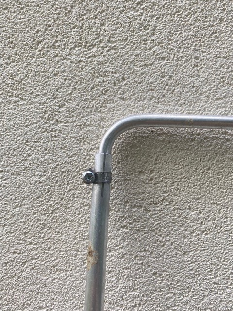

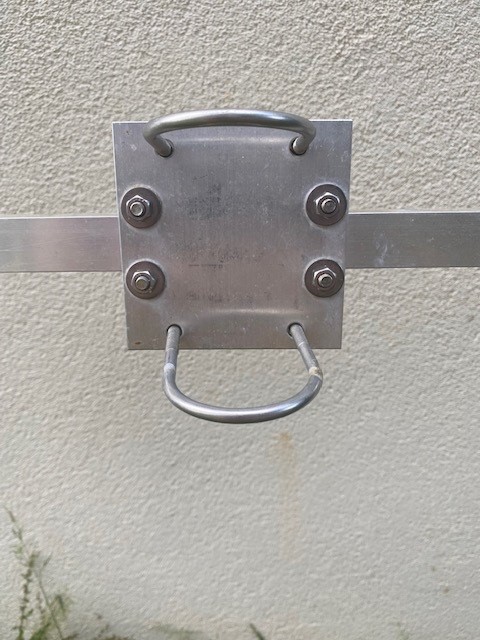

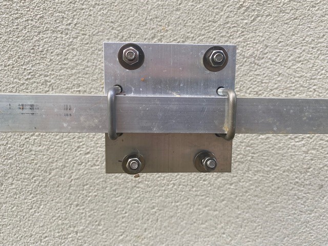

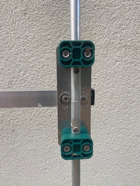

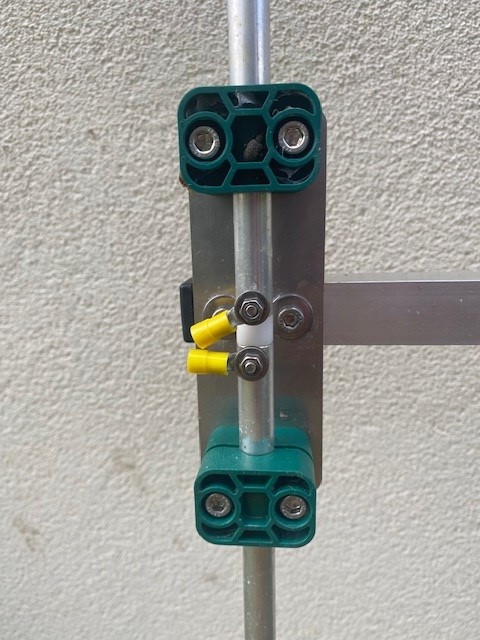

So I have received my eantenna 6mox moxon antenna and it is now built, I did not find the instructions to helpful so attached are some images which may help

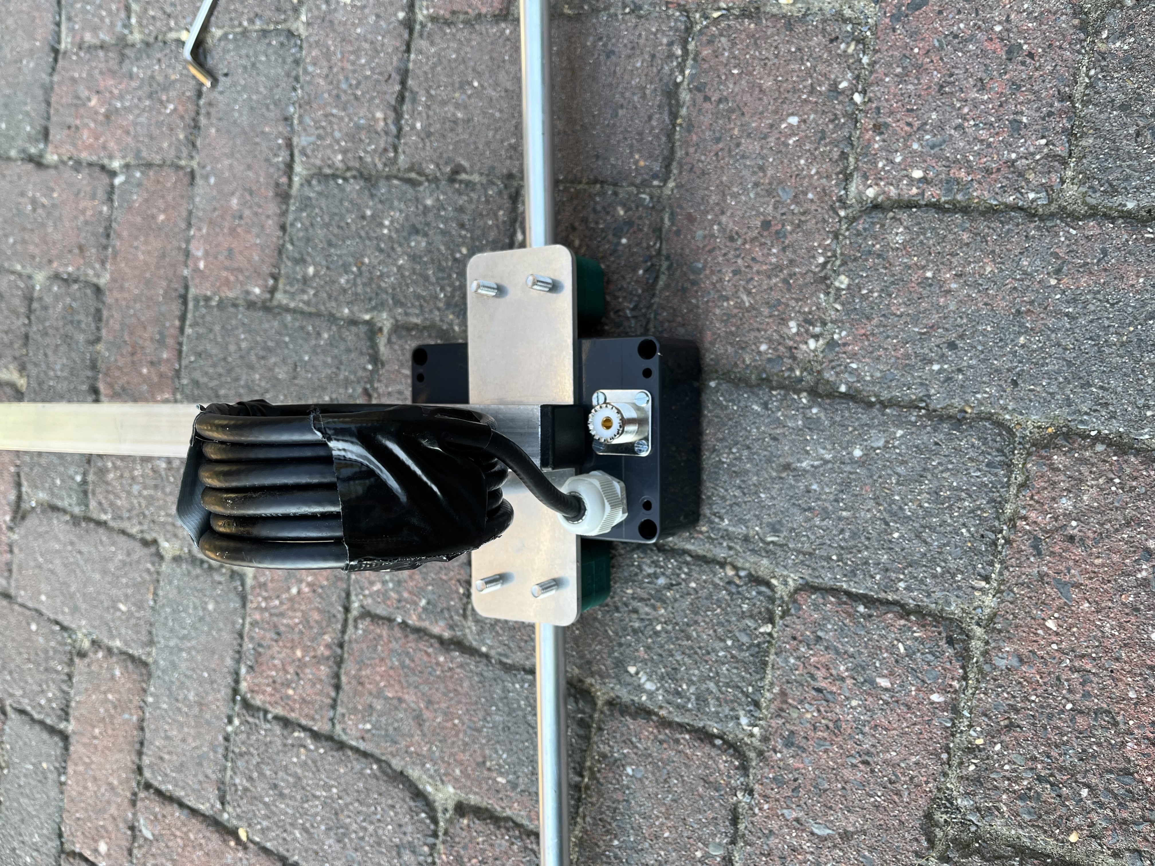

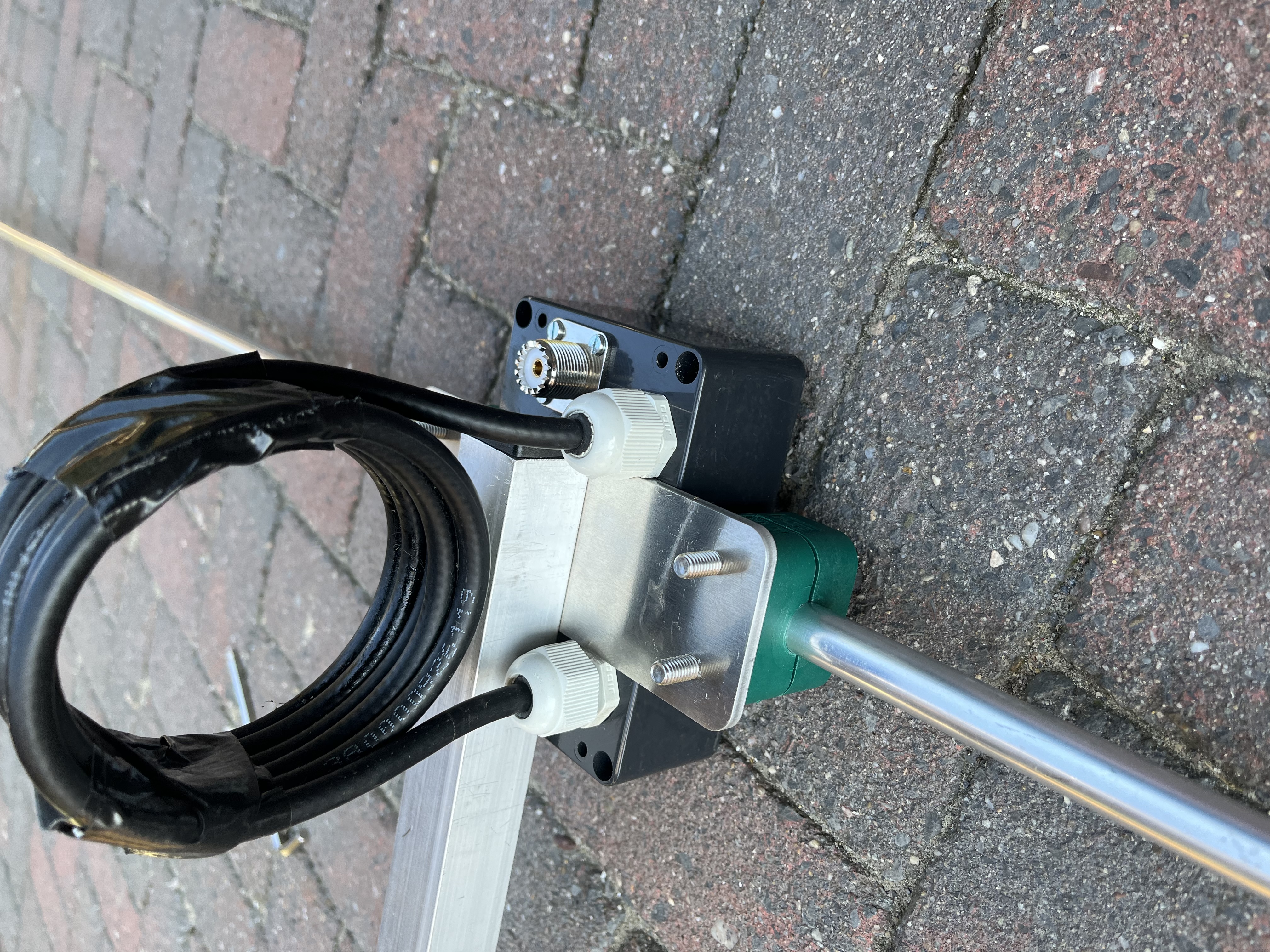

I added a cover around the driven element to give shelter to the coax connection, the coax smoke and a SO-239 Jack.
