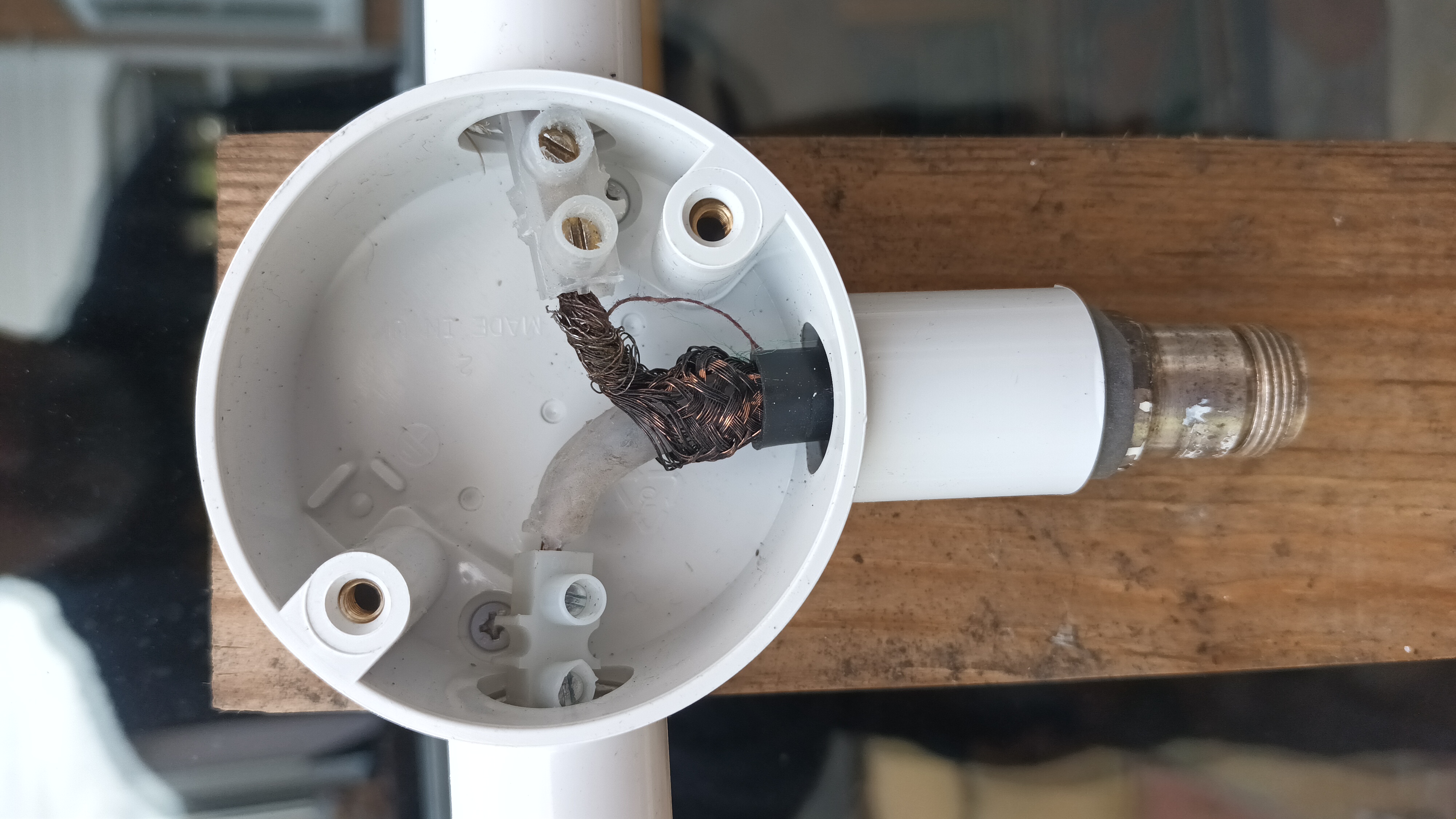

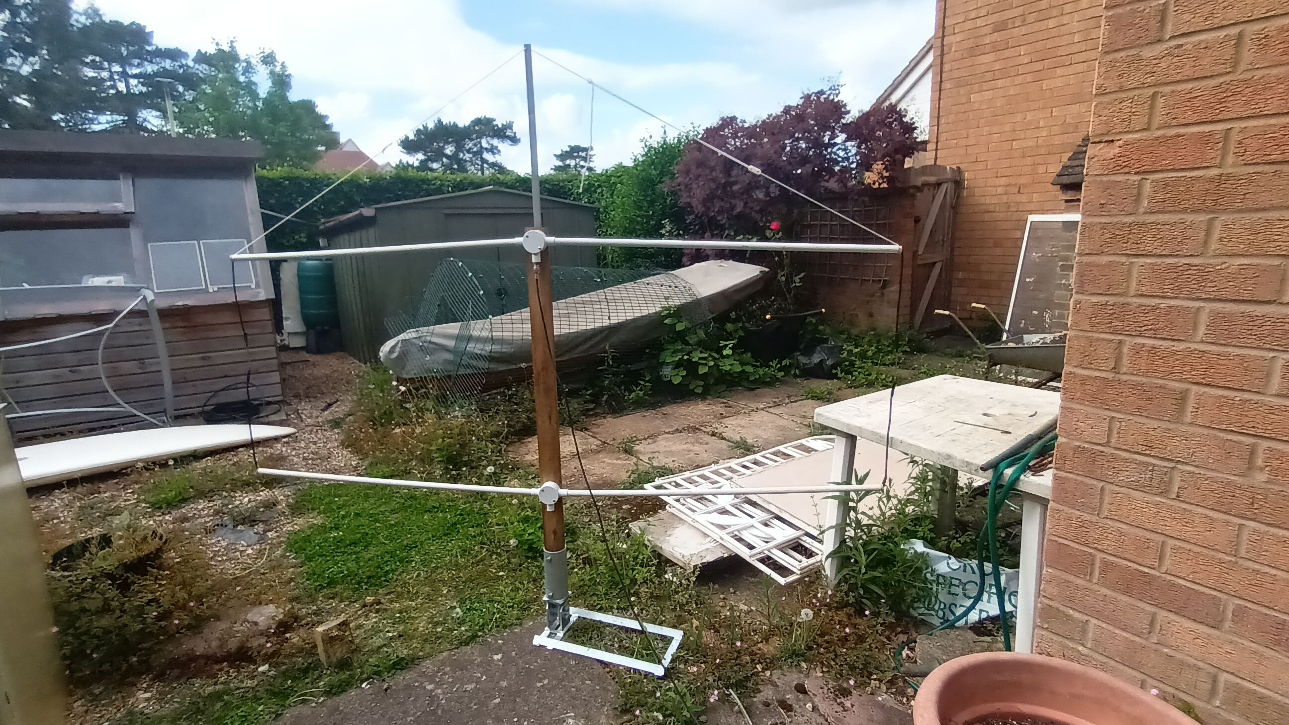

I have just got a vertically beamed Moxon up and running. It is made of insulated wire in 15mm plastic conduit. I had to add a catenary string to keep the driven element horizontal as in the attached photo. An N-type connector with a bit of tape around it fits snugly in the 3-way conduit box. The insulation and PVC pipes mean I had to trim about 3cm off the wires even though I had already modeled it for 0.95 velocity factor. It still resonates at around 49.9MHz, but I got bored with snipping bits off the wires and taping up the insulated spacers. The SWR at 50.4MHz is around 1.2.

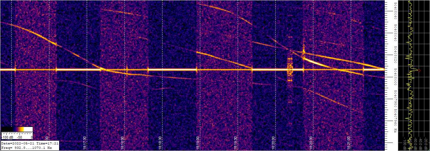

I can swap between my 4 ele yagi which is around 8 feet up presently and the Moxon. The Moxon shows a much higher noise level, presumably because of the large area of sky noise. However, some aircraft trails are stronger on the Moxon than the beam. I have tried to align the Moxon to cancel as much signal as possible, being only 50km from the beacon, but there is still far too much direct carrier. I have also attached a plot from Spectrum lab covering the last 5 minutes.

Here is a plot where I switch the antenna every 30 secs or so from a 4 ele yagi to the vertical pointing Moxon - now slightly tipped towards the beacon. As I stated earlier,the b/g noise is quieter on the Yagi, but the aircraft trails are usually brighter on the Moxon, and the direct carrier is definitely weaker on the Moxon.The jury's still out at the G3OVH QTH.
